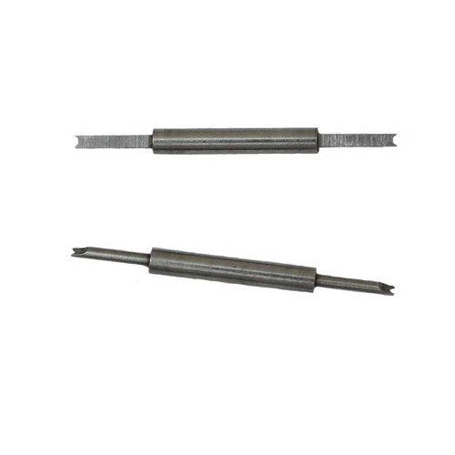

                    tape the lugs
                    use this bergeon 7825. the tips are made specifically for rolex.
