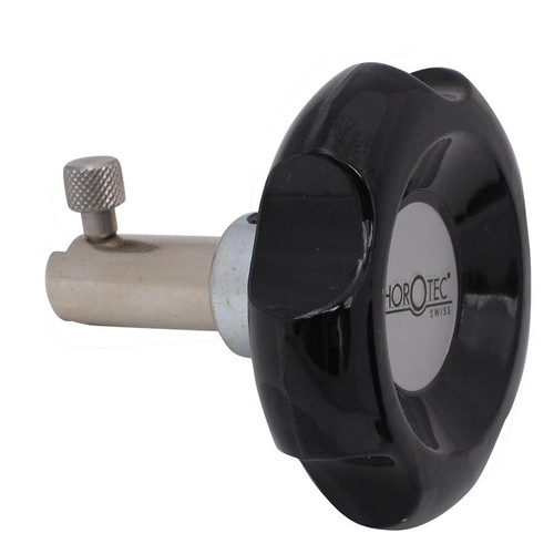

                          • Whenever possible, always deal at RSC (for Rolexes). It is worth to pay the verification cost for peace of mind. For the trained eyes, hand and ears, always open the caseback for verification. Best tool to do it is actually a Horotec hand tools with the proper Rolex dies (can change from one model to another).
                            For illustration only:
                            Open your watch case back the easy way with this must have multi purpose tool. The Case key die holder wrench can hold a wide variety of cases. Its fits Rolex® dies and others allowing the dies to be used in a case back remover and opener wrench Horotec MSA 07.305 die key wrench mount holder 8mm dies.
                            With the dies:
                            Watchmakers parts and watch repair tools and supplies including watch straps, batteries, movements, and clasps
